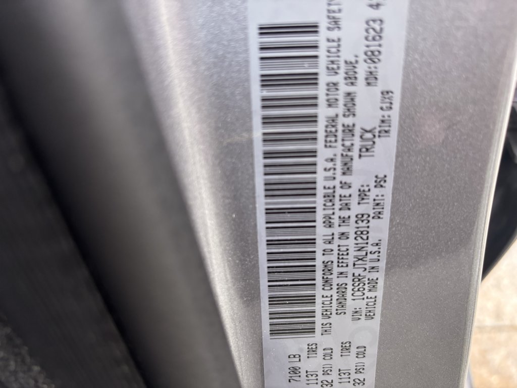

I’m new to this forum and i
don’t know how to dm.
