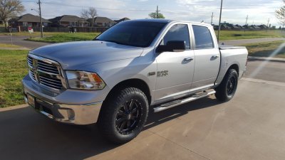

welcome, being 2WD, check out Maxtrac, specialize in level/lifted 2WD's.
If you level, you can go up to a 285/65/20, this is what I had on mine first, see below. Far below is new Maxtrac 4.5/3" lift and 35's

MaxTrac offers 2wd leveling kits. I have their 2.5” coil springs and 275/65/20 Toyo AT tires. They’re a little bigger than 34” and I still have more room. Never have scrubbed.
