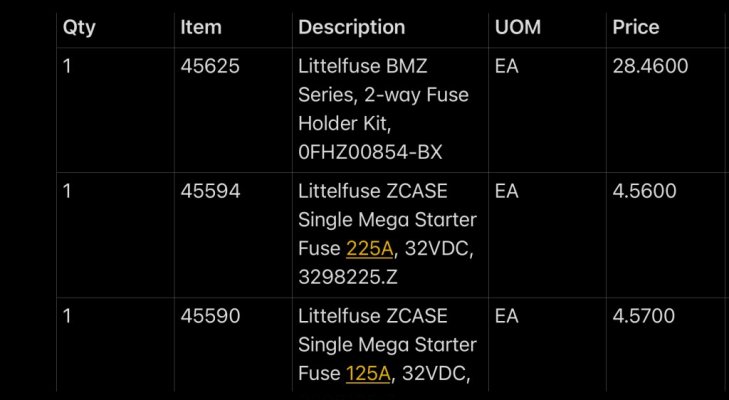

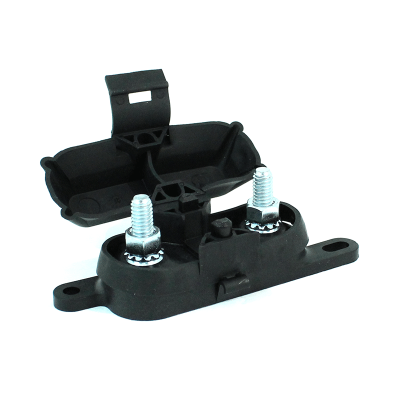

Do you have any suggestions for an inline fuse thats 320A for the positive battery cable since you seem to know something about them.
You'll burn the truck up,using a 320amp fuse.You put 320 amps into the stock wiring,there's gonna be a hell'va smoke show in a very short order.Stick with the stock fuse,or at most the higher amp 220 factory fuse.If you haven't noticed,all the higher amp alternators reconmend upgrading the wiring,so get off your ass and do the Big 3 as it's called,which i've been telling you to do for a week or more now,lol. And don't use 6 gauge,at least use 4 gauge even if you're piggy backing the factory wiring.There's a stud behind the battery,that makes for a good junction block to run your extra grounds from,i'd run extra grounds to both the fender grounds,from the engine to the ground stud,and from the frame to the ground stud,also doesn't hurt to run an extra ground from the back of the frame to the box,if you're really ambitious you can even run a ground to the pass side frame rail,that way both sides of the frame are grounded solidly.I even ran a ground to one of the studs that the PCM mounts to

I can only find 300A automotive fuses but holder is rated for up to 500A this is for someone who wants to do the big three using a larger that stock alternator
( 220A)
Jan 17, 2016
23,853
54,912
14 Sport
I can only find 300A automotive fuses but holder is rated for up to 500A this is for someone who wants to do the big tbree using a larger that stock alternator ( 220A)
Doesn't matter,the interior wiring/headlight wiring ,fuse box etc.,won't handle 320 amps,you must think the wiring ends at the engine or something,lol.Stick with the factory 220 fuse at most.Go back and reread my post,i just updated it.
