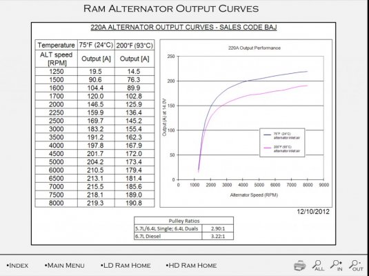

What I found was the OE Specifications of the different alternator
Output Curves for RAM Trucks 2016 1500 it covers
160A, 180A, and 220A
The last Chart is for Cummins Only
Notice specifics for engine size and pulley diameters
RPM’s and Temperature
41384186-CFB5-45A2-A521-DA0C177C21F4.jpeg41490D60-775D-488B-8AAA-A8EB8CA0A452.jpegCF595B98-F548-4FAA-93E5-488C93D3740E.jpeg033F9103-DFA3-4AD9-A28E-DB63E7DB01E2.jpeg

How does that show improved fuel mileage
In an example of electrical continuity the more balanced a system is the less (fuel) energy it uses,
wasted motion is wasted energy conserving motion through continuity saves energy therefore fuel
But the most obvious savings is in maintenance and prevention because it’s the most easily understood.
the charts don’t actually show fuel savings they show comparisons between the offered OE options.
The interest in this thread is saving money only one aspect is about saving fuel and that is still conceptual regarding who is behind the wheel.

This is the first time I have ever heard about this theory of a larger alternator providing better fuel economy. Motorsports has been my hobby for 30+ years and I spent 12 years in the automotive engineering field including a lot of time performing fuel economy testing and sat on SAE (Society of Automotive Engineers who publish recommend test procedures for many things) committees on it. I would have to see the force curves required to turn an alternator at different loads, and see if running an 160 amp alternator at 50% load is really that much higher than a 220 amp alternator at 36% load. I would think that the extra force required to spin the heavier weight internals of the larger alternator would likely counteract any savings you would get but running at a lower load %. This the same basic theory as saying you should put a larger and higher horsepower engine in a car so it will get better fuel mileage.

You could say weight has something to do with parasitic drag coefficient but remember inertial has it’s own benefits .
I don’t believe a larger amp alt has any benefit in my specific application but that in lower RPM a 160A or 180A would be more complimentary .
Alternators generate a significant amount of radiant heat and a larger alternator would generate more under hood heat.

What you need is info on how much horsepower it takes for each alternator to generate a specific charge current. This topic implies that the 220 a alternator uses less hp to generate 100 A than the 160a alternator.
