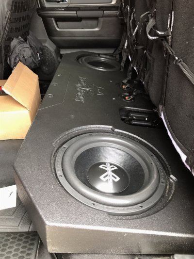

Here is my setup
Alpine pxe850s signal processor and 12 channel amp pushing 25 watts to dash, center, ceiling @ 4 ohm
Crossfire 800.4 (100 watts per channel @4 ohm)
Kicker kx 3.5” 4ohm dash speakers
Kicker kx 3 way 6x9 4 ohm front and rear doors
Crossfire 1000.1 pushing 2 crossfire 12” dvc 4 ohm wired down to 1 ohm
Fox acoustics box
