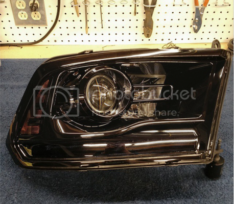

Decided This is what I really want! New set just ordered on the Weekend with FX-R's
I paid extra to get them murdered out too...to match My Blacked Out Ram

an HID upgrade can range from $155 for just bulbs/ballasts/harness
up to a full retro-fit HID upgrade, custom painted/tinted 13+ projectors
with the Big 3.0 FX-R's and adapters .... around $1500
My local dealer wanted over $900 EACH for stock OEM projector lamps, $1800/pair (Canada)
That's a LOT of money for crappy halogen output IMHO
I paid substantially LESS than that with a crap load of upgrades from Jeremy.
They Look So much better than stock and as the pictures show, flat out destroys them for performance.
