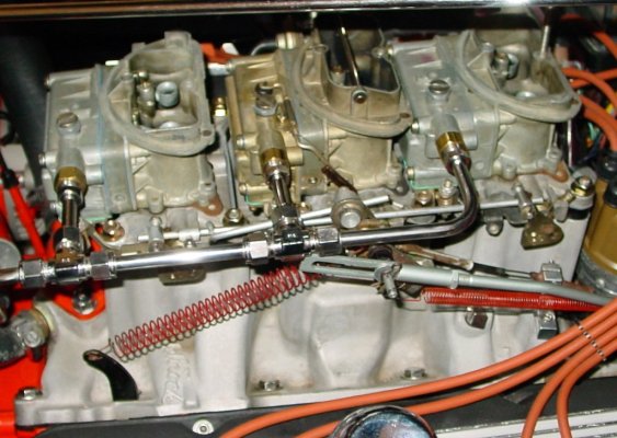

here's a few, Bought the car on Super bowl Sunday 1983 and slowly redid the car doing major improvements to it every winter. Having always been a Mopar guy it has a 340 / 727. I pretty much did everything except the upholstery, exhaust, and front end alignment.
Some day I'd like to get back to it being a hobby but with 5 acres and at 70 yo it seems there is always something to do, like buying a 2014 RAM and proceeding to try and learn about that which I knew NOTHING about :emotions122::emotions122::roflsquared::happy160:
This FORUM has been a great help and I hope to become a contributory member as much as I can
Thanks to ALL

Wow that's beautiful TJ.You should start a thread on it here and give us some more pic's of it. :waytogo:
