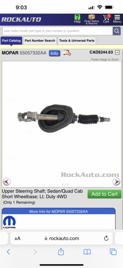

Guess the sound has everyone baffled too, I am going to purchase the upper part of the steering shaft that comes with the rubber boot like in the photo. I am very new to ram and didn’t wanna waste the money had it been something common that others knew about.

I haven’t noticed any excessive play in steering, just the clunk right now. I will check here in about an hour (I watched that video) I’ve only noticed the clunk from what seems to be coming from under the rubber that seals the firewall, not sure if there is a bushing or knuckle in behind there or not, I didn’t want to force remove it and end up ripping the rubber.

Have another person move the wheel back and forth while you locate the issue. Start at the firewall and work to the road, grab the shaft while it’s being turned to determine if it is in the cab or below. Or just start replacing parts ,sooner or later you might find the broken piece.

Got my wife to jiggle the wheel while I held the shaft (wow that didn’t sound right for a public forum ) I can barely feel the clunk in the lower shaft, it’s way more pronounced on the shaft that goes through the firewall especially close to the firewall where the rubber is.
It would be a lot easier if I had ever owned a truck before, but I have mostly cars/SUV’s and vans, I had an issue like this with my 2006 Equinox the same clunk and it needed a steering shaft maybe that’s why my brain is telling me that is what’s wrong with this.

Truck just got out of the shop a couple hours ago, the said it isn’t the steering shaft BUT it is the steering column that needs replaced.
$1,7xxCAD however I mentioned it to the salesman a couple weeks ago so from what I gather the dealership is going to cover the costs.
