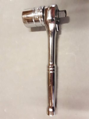

I get the filter off with a 24mm and one universal, no need to remove the intake.
I use mopar filters and pennzoil platinum 5w20 every 5000mi. Oils life monitor usually reads 40-45% when I change the oil. It’s cheap insurance for me.
I've done a couple changes so far and use a "three-way" 3/8-sized ratchet handle that has 1/2", 3/8" and 1/4" drives (found it at Walmart). No need for any extensions or u-joints.
To the OP, take note of where the O ring is on the filter housing and put the new one in the same groove and rub some oil it. Some folks put it in the wrong spot. Also don't over-tighten the filter housing. Just make sure it's fully seated. The O-ring seals it, not brute force.
The Pentastars are about the easiest engine to change the oil/filter on IMHO. I've been using the OEM Mopar MO-349 filters and Mobil 1 Advanced 5/20. BTW you can change the filter any time if you wish and not lose a drop of oil. Say if you want to run 10K miles on an oil change, you can change just the filter at 5K.
