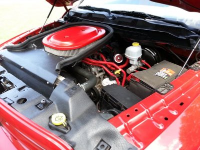

10-4! Good luck! I really like mine. Just a suggestion though, I would recommend going to your favorite parts store and buying a different filter instead of the chrome one with the kit. It may be fine, but looks very cheesy IMO. This is a good chance to spend just a few more $$$$, less than $10, and pick up something that looks good and will dress up the engine compartment. It is going to need some dressing up because it looks like Hell with the Vararam on and the engine cover off, at least to me anyway. Also, the plastic split hose covers go a long way and cheap as well. Here is mine:
