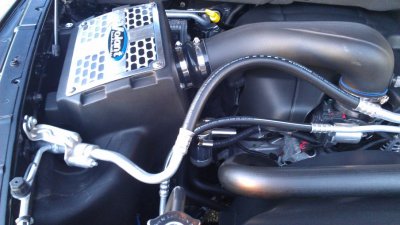

Any pictures..?

Not the best pics but should work.

The Volant looks good in there!

when did volant change the design for these models? Volant was my first choice of intake but i heard alot of bad reviews with fitment. Looks good!
This is their '13 CIA. I also read about those fitment issues but mine went in without a problem. I did take out the OEM box tray just incase there was a problem. Fit nicely in that spot. I also took an 1/8" off the intake tube at the box connection to have the tube sit squarely inside my 87mm TB but that would have been fine with stock 80 mm TB.

Looks good, that engine cover needs some paint though...

Been a few months. What's your opinion of the intake now?
I like how it's a performance intake / looks fairly stock.
I like it, but it became a restriction upper rpm range with my cam/ported heads. So, I use the Vararam for spring, summer, fall, and then I'll switch back to the volant during winter.
