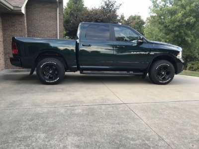

really good looking!.....how much rake did you leave in?

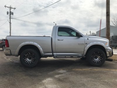

I have Bilsteins set @ 2.8 and stock in the rear.... Mine's level. I'm running 295/60R20 tires and I think it looks pretty good.
