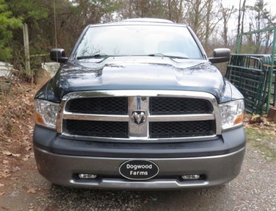

So now this truck has no fog light openings , so i'm thinking maybe something can be done with the
tow hook openings as it has that plastic insert in it now it is the chrome bumper.
Any help will be greatly appreciated. 20180224_120247_HDR.jpg 20180324_150628_HDR.jpg

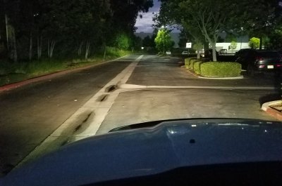

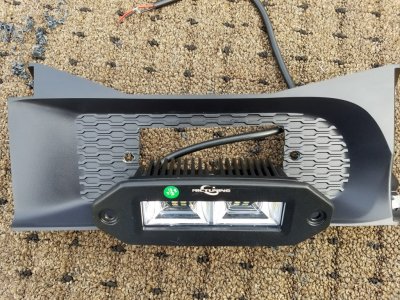

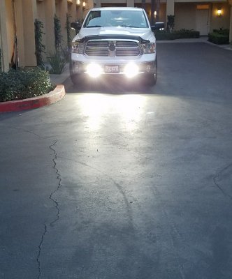

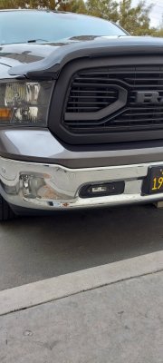

Fog lights or would you like some driving and fog with a light bar?

^^^ Those are nice! ^^^
