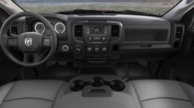

So, I have a 2019 1500 classic, and I do not like the radio section and center console, any suggestions as to how to upgrade them- bigger screened radio, get rid of center seat for full console?

The radio should be pretty easy to replace. You have a lot of choices with aftermarket radios.

Have same in my 17,been looking an findin lotta upgrades but concerned about the bezel
without changeing bezel whats the options on systems?
from what i can tell this is VP1,does the VP2 have touch screen and fit?

This is the stock upgrade. 8.4" touchscreen. Maybe you can find one used.

Very easy upgrade if you go stock radio and bezel,probably take you about an hour to do.There's a thread in the d.I.Y section that explains what to get and how>Infotainment have a video on how to do it.
