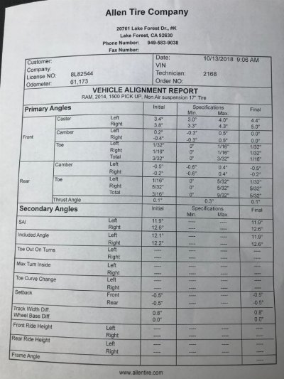

I looked at the aligment sheet since it was the only thing that changed, and it's when i realized i had now 3.4* of caster on that side, 3.8* on the passenger, which is still under normal specs, but i'd have never ever imagined one single degree of caster could have done something like this, but what the heck, i took her to the shop this morning, and had her aligned one more time to 4.5* driver, 5* in the passenger, that opened up the gap once again, which is what you see in the picture above, at about 1.5" though the camera angle doesn't show it, i'd think i had about 1" before as i shaved about than 1/2" of that plastic.
This is my new alignment sheet showing yesterday and today difference, i still can't believe 1 damn degree of caster can make the thing rub, but oh well, it's was the rubbing culprit in my case.
