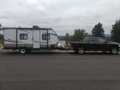

FWIW, Etrailer finally did say there were no softer bars I could swap out but I have a call into Curt.
The bolts are Grade 5, according to the markings on the bolt head.
I re-adjusted the WDH to where the before and after measurements at the TV front bumper and TT couple height are exactly the same. However, the rear bumper height is down 1" after WDH is engaged. (see pic) The WDH head is in position #3 (out of 5) so I figure I *could* add more tension to the bars (position 4?) and raise the back, but I'm afraid that might be TOO stiff (bouncy ride) and could also increase the steering weight. I figure it's close enough so will be heading to the scales, armed with VernDiesel's CAT Scales "how to guide" info and just where I am at and go from there...Truck n Trailer.jpg

Looking good! I don't think I'd have to scale that if it was mine. Your well within the capabilities of Your truck, at least as far as I can tell. Minimal truck rear end squat. Trailer has just a slightly nose down attitude which is what you want (level or a touch nose down for proper tongue weight) that should tow well like that from what I can see. Let us know how you make out. Happy camping!

The rear is going to squat some. There's no getting around that. What you should mostly be interested in returning the front to as close to unloaded as possible.
Really, the goal, once hooked up, is to have the trailer level or slightly tongue down, and the TV's front end returned to unloaded height while staying level or slightly ass high.
I'd say your setup looks pretty good. You're way under weight for the truck, so it should tow good.
