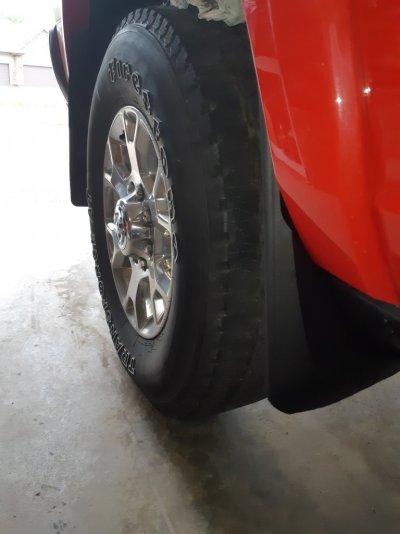

I thought this install might be of interest to other guys that spend a lot of time on gravel. We all put Mud Flaps on the front and rear to try and reduce flung mud and rocks, but that doesn't stop stuff from getting flung forward by the rear wheels, particularly rocks, that like to chip up the lower panels and doors. For years I have mounted a set of flaps on the front side of the rear well to cut this down.
I put Weathertec no drills on this one front and back and they were a great fit.

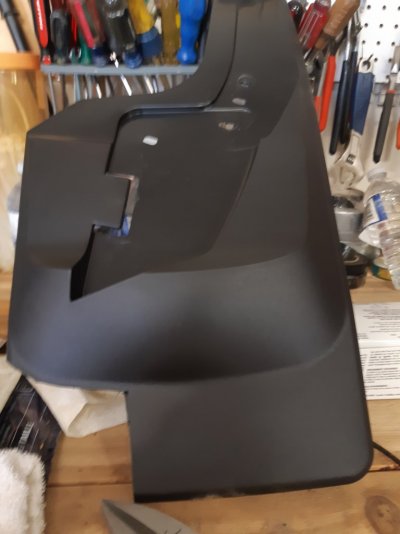

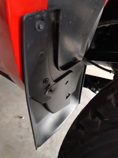

When I got looking at the rear flaps I got the idea that I could easily reverse Left and Right and have a no drill mount for the front of the well too. In the end it worked out well, but I did have to drill another hole in the mudflap itself to get it to line up with the bolts that hold the factory flares on. I also ended up having to trim the guards because they hung down a little too far when mounted on the front. While I was at it, I took all the bolts that hold the flares on out, covered them in black RTV Waterproof Silicone and reinstalled them to ensure there was no bare metal anywhere. It was pretty easy so I may do that on the front now as well.
Front and Rear Flap mounted, after front flap trimmed.
This is the rear wheel, rear of wheel well flap. I think the fit is a close to perfect as you can ask for.
Trimming Length of Flap, and extra hole drilled to match existing bolts20210907_134021.jpg

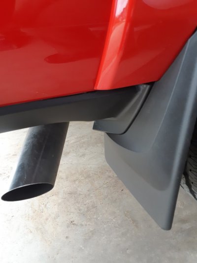

Flap mounted after trimming. Prior to trimming it sattoo close to ground level. See next picture down for mounted prior to trimming.20210907_135203.jpg20210907_133241.jpg

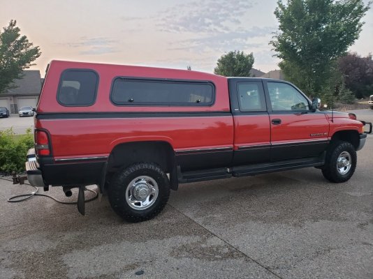

I will take a picture and post it of the new truck with this set up but it isn't handy. This is a picture of my 1996 Ram 2500 V10. It actually has triple flaps on the rear since new because I pulled a fiberglass boat a lot with it. I actually think it looks just fine and given that is the original paint at 160,000 miles, most of it off pavement, it definitely kept the rocks from chipping the finish..

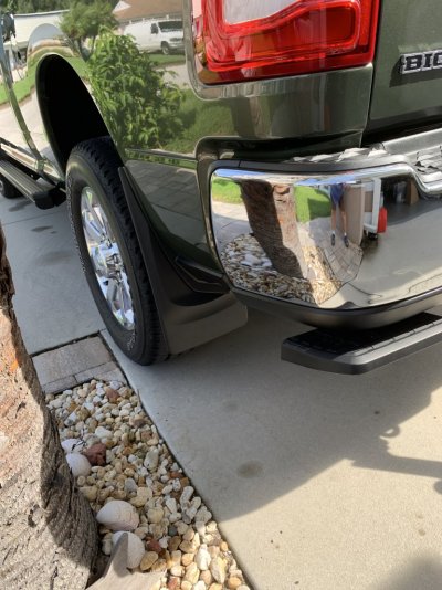

Just put mine on. 30 minutes or so including cleanup.

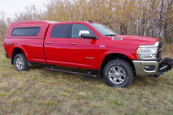

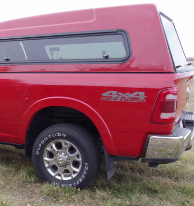

I said I would post a picture so you can see what the mudflaps on the front of the rear well looks like so here are a couple. It doesn't look like it because of the camera angle but the front flaps are the same length and hang down the same amount on both sides.
Power Boards are in the Deployed mode.
Close up
