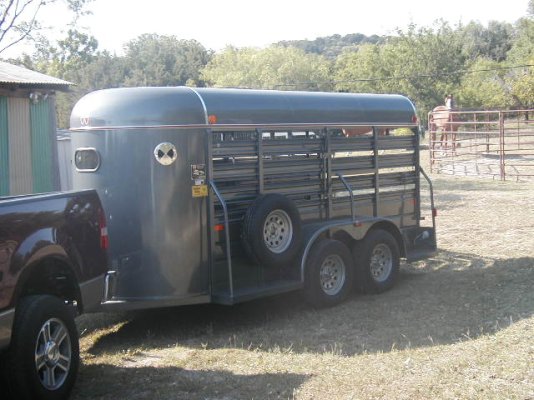

Yessum, U be 100% correct, royal PITA, and if I did it again, I would do a Roll N lock, than full cover. But the full cover painted to match vehicle body cover does set the vehicle off real well. Security, well it it fiberglass, but definitely keeps the bed of the truck purty dry.
ADDED: If I need to get ne thing big, instead of pulling the cover, which is a 2 man job, I just hook up my 14' trailer and use. A lot lower than truck bed and easier to load and use, just a small "fuel" adjustment.
