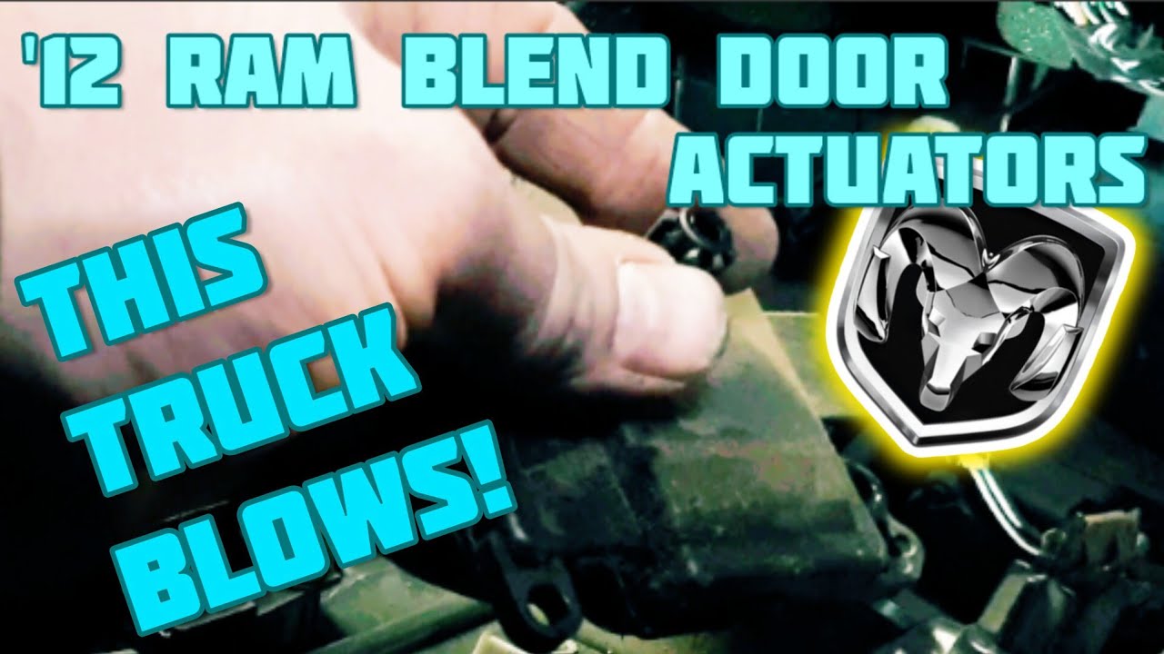

Mopar Actuators are stronger, as in beefier
They also work with the Hvac control module to self calibrate
The Clicking noise that you hear over at the glove compartments, is likely broken teeth on Blend Door Actuator..
I will look up a video that should help you
this video is a DUAL ZONE HVAC System
most of the actuators locations are the same
hopefully, you noticed that when he manually worked the White Plastic pieces, you heard a thump.
That was the Door that is inside of the HVAC box & that means that the door is still attached
That is what you want to hear & feel :)
