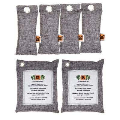

Store the truck with the windows open for awhile.
Look at some of the products used for boat storage like bags of odor eliminator with charcoal.
Put a fan in it. Drive with the windows open.
