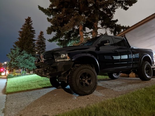

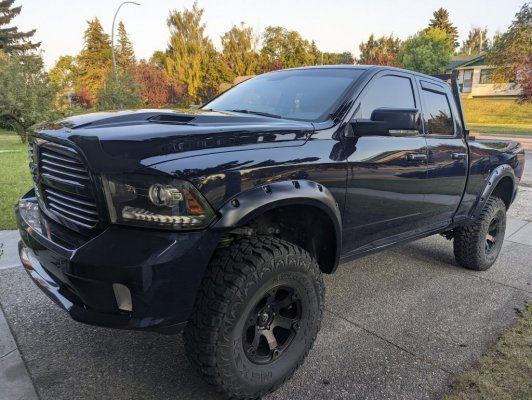

Put my Sport bumper back on to relief the weight in the front, kinda liking the original look.
There is a company in my country Canada that makes a hidden winch behind the stock bumper and reinforcing the middle area versues the weak stock one, so I am probably get that:
The big bumper and tires cause a lot of stress in the wheel hubs and ball joints.
Next project: going Dana 80's with lockers (if its possible..)

What do you think the weight difference was?
Both set ups look good. Guess it comes down to what your actual use will be and personal preference.
Can’t go wrong with either look :waytogo:

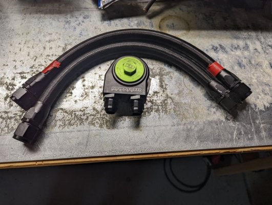

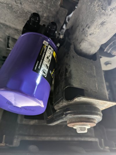

Started putting together my remote oil filter parts today and found out my Earl's Oil Filter Mount 2177ERL doesn't thread the filter on square and leaves a gap between the mount and the filter seal on one side, so that's.... bad I think. Summit doesn't want it back, so a refund and an upgrade to Improved Racing ENV-140 mount to match the Improved Racing filter adapter I already have. Should have done this mount from the beginning.

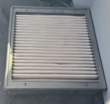

Found a brand new(slightly used) AirRaid SynthaMax (non-oiled) filter for $10 on FB. Been wanting one, I had the K&N oil filter and was not thrilled with the oil process. Had one in the past and it would coat the MAF even new from the box. Gonna be nice to use Dawn soak and rinse.
