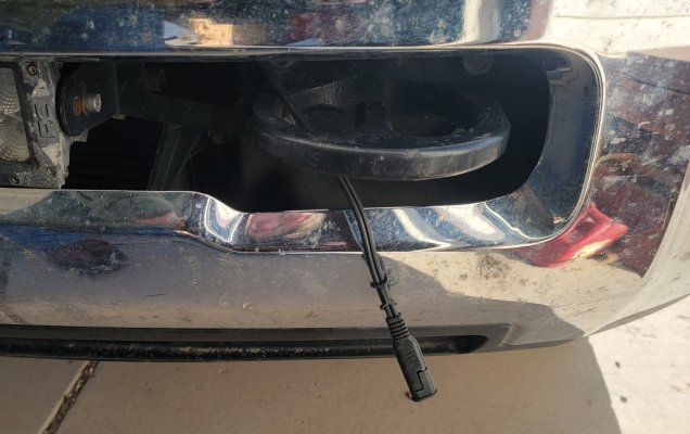

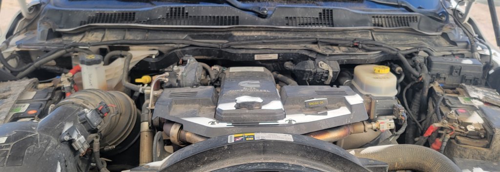

got tired of trying to hook up the battery tender in crappy weather and having the hood try to fly away with the winds and snow we get most times. Snipped off the one end and put ring connectors on a 25ft tender extension cable. This way I can do the split charging (+ on one battery and the - on the other). I ran the far cable in with the hood pod light wiring and took the molded connector out the bumper like the block heater plug.
Top loom
tucks in when driving

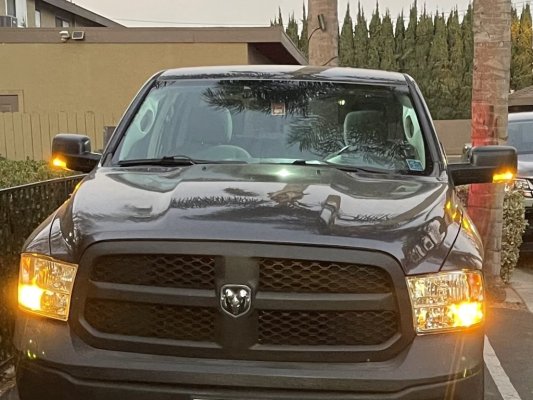

Bought, installed and programmed a used set of OEM mirrors with the lights AND auto dimming. It took me a bit to find a set with the auto dimming. (Both sides have the additional wiring, but the programming shows an open circuit on the passenger side…I wonder if they replaced the glass at some point?)
I was pleased to find out that all the features except the power fold worked with my existing door modules (I don’t care about power fold)
I’d love to have the mirrors also be running lights, but haven’t figured out that piece.
On a side note-I love the look of the Morimoto lights but can’t justify the $$$ - has anyone had good luck with any of the more cost effective units? If so, would you share a link? Thanks!

I put these on my truck, since the stock ones were pitted pretty good. Cost me a whopping $65. They are not available from this seller right now, maybe another seller would have them or something similar.
Here's a seller that has something very similar to what I bought.
