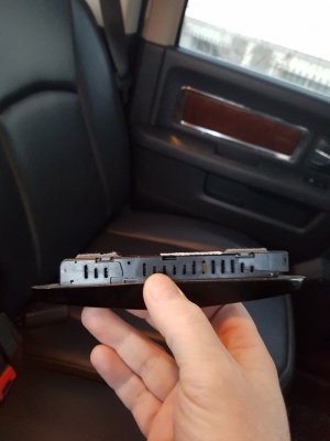

Hey all:
I recently bought a used 09 Laramie and have been wondering what the interior part just above the sliding rear window is for. It looks like an infrared bar or something. I have heard that it maybe for the auto climate control or maybe has something to do with park assist. Any Ideas?

Not the best pic but you can see it between the window and dome light

A light tug to the side and it comes out. I tried to run a search on the part numbers but came up empty20180113_075308.jpg 20180113_075320.jpg 20180113_075320.jpg

Might be the sensor that goes with the back up assist ( those lines and grid that come up in reverse) . Or it was planted by the Germans to read your thoughts.

@patchelect THANK YOU!! This helps me get one more step closer in trying to diagnose my park assist fault. Wasn't sure it was a component of that system or not. I think it has 4 lights that illuminate and correspond to what sensors are picking up an object. Now to pull out the volt meter and see what's what.

That should be the display for the back up sensors in your rear bumper. Park assist.
