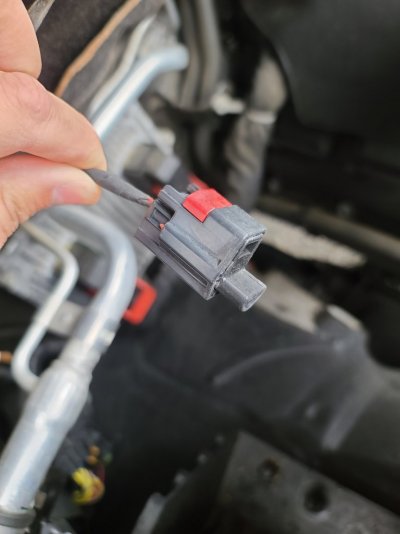

What does this thing do?
audiophile
Aug 13, 2015
1,037
1,106
5.7L
That is for the under hood light. You can add it and it is just plug and play.

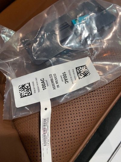

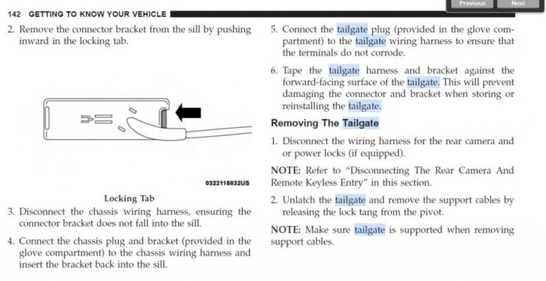

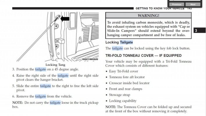

What about this found in the glove box of new Longhorn?
That is the plate cover/adapter parts for the wiring harness when you remove your tailgate.IMG_2202.JPGIMG_2203.JPGtg1.JPGtg2.JPGtg3.JPG
