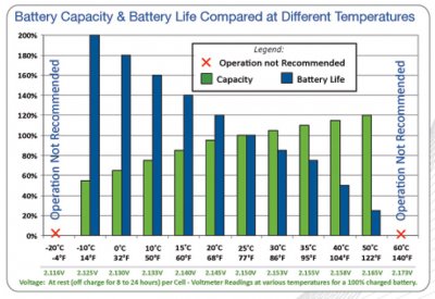

Your battery should still be fine.
I still have my OEM battery in my 2016 and it should/might/could still start the truck in cold weather even at the "operation not recommended" temperatures.
Come winter that's when you'll know for certain.
Lead-acid batteries...

Your battery should still fine.
Looks like I use mine when not recommended an aweful lot.
Just had the OEM battery replaced under warranty in our 2018 RAM 1500 during first cold snap in rural Nebraska. Went from working to stone cold dead. Purchased Certified Preowned so it passed dealer's inspection once anyway.
Have seen on RAM Forum references to some 2017-2019 (Classic) OEM batteries crapping out prematurely. Just retired from 20+ years as a computer tech, battery manufacturers can have bad production runs where the problems take months or even a year or two to appear. At least the RAM ones don't burst into flame!

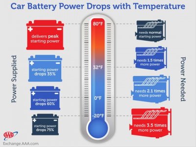

Cold weather is a battery killer.
Grand Mesa
Jan 9, 2018
1,687
1,768
Cold weather takes a double whammy on the power supplied and the power needed.

As I've been told by a battery guru- the hot weather is the culprit that does the damage to the battery. However it shows up in the cold/winter weather due to the increased demand for amps on cold start. I thought this was a line of houie, but I had a Buick Riviera that had the battery under the backseat, not in the hot ass engine compartment. That OEM battery lasted right at 6 years!! The best I have gotten with batteries under the hood is 2-3-1/2 at best. So based on this experience I figure he was right.
The batteries in the HDs (not sure about the Hemis) have a "blanket" around them to try to insulate them from some of the under hood heat. I'd bet good money theyre trying to make em last to 36,001 miles or 37 months to avoid having to replace them under warranty!
