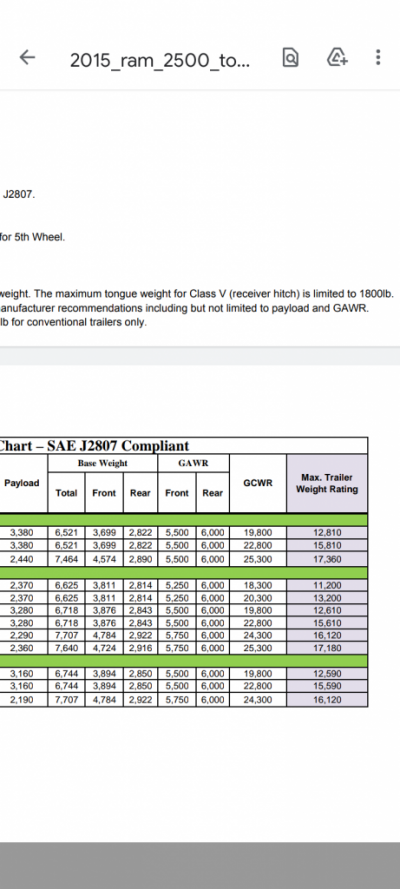

And as you can see the maximum trailer rating is 17360
So 12 to 15k would be bellow the limit and perfectly fine.

says in that brochure up to 17-18k pounds if properly equipped, meaning if said hitch is only rated for 10k pounds then thats all it can handle. still not clear lol getting there, like 98% there
Yes. Because a HeMi tops out lower than the diesel.
Properly equipped means with the diesel and a low enough trim package to fit withing the 10k GVWR and the 25300 GCWR
1800 and 18000
But, this might be with a weight distribution hitch...hahaha...love fine print.

i getcha - so safe to say for my trucks tow package - tongue weight max is 1,800lbs and max trailer weight to pull is 17k and so many pounds

Yes. A 2500 can tow it's max trailer weight with the receiver hitch
A 3500 max tow would be with a 5th wheel or gooseneck.
The max tow on the new trucks 3500 dually diesel is only atainable with the goose neck ball.
