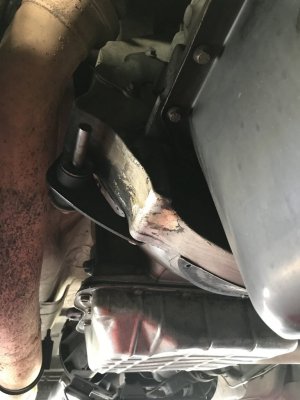

i have no idea what this is, but it was open. It can also close. So I’m wondering what it is and if it should be open or closed.

On a diesel probably alternate starter location or unused PTO access

Forgot to mention. 5.9L Cummins. Don’t know what that is.
I figured you were talking Cummins since your picture says 07 & 5.9
PTO = Power Take Off
For powering hydraulic pumps, water pumps, auxiliary stuff etc

Oh ok. So doesn’t matter if opened or closed. I might as well close it though.

Yes and no, it's a dust cover. You don't need road crap getting in there.
