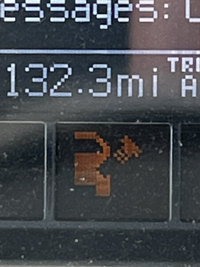

What light is this on the dash?
edelsite
Dec 13, 2018
Mountain Home, Idaho
2009
I didn't see this in any other thread, so I figured I'd ask. This light isn't in my owners manual. Looks like a gas cap to me, but I've been wrong before.
turkeybird56
Aug 2, 2018
25,692
56,364
Central Texas
Fuel Cap Light.
GTyankee
Nov 2, 2020
12,391
17,460
El Cajon Calif. 92021
3.0 ecodiesel
The ESIM Near the Charcoal Cannister
The Purge Valve under the hood
May not be exactly where there were shown in the video
The 2009 Dodge Ram may have the Purge Valve located just under the Battery
Both of them are more likely to set the Gas Cap Light to come on, than the actual Gas Cap
