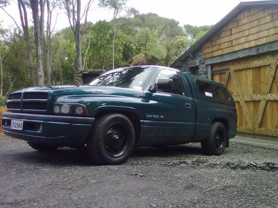

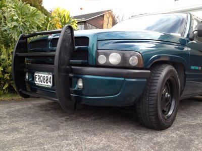

I have a 1996 Dodge Ram 1500 lowered with dropped spindles.
How do I know what shock absorbers I need to buy? Or with it having dropped spindles does that drop everything proportionally so that the original OEM shock absorbers will work fine just the same, such as is sold by Rockauto?

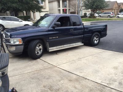

terribly sorry beauduke or I didn't chime in sooner. We are more or the less the only ones with lowered rams on here.
With drop spindles, the ride geometry doesn't change so stock size shocks are fine.
I run a lower coil and hanger flip with drop shackles, (or at least I did now just hanger flip)
