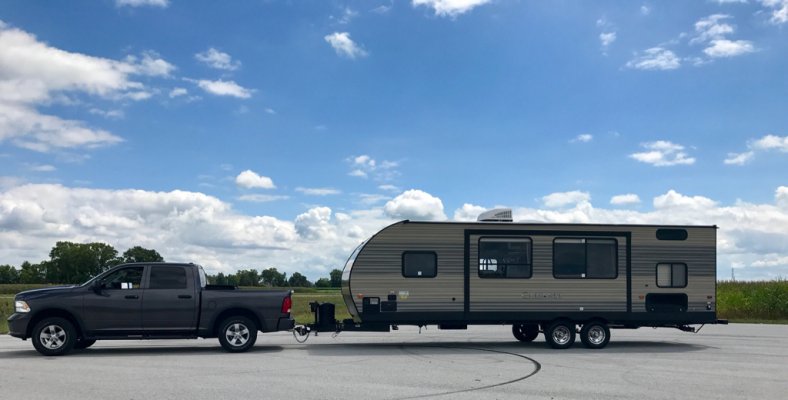

7ae7322daad04c62607ccfd442ef94a6.jpg This truck is 3 times my 1500. But I sure did love stomping on the 5.7 with the 8sp and getting shoved into my seat!

Exactly right, axles, BRAKES, suspension, bearings, BRAKES, Cooling, frame, and oh yeah BRAKES!
Amen!

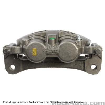

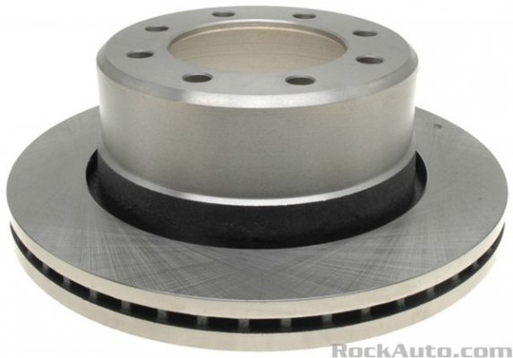

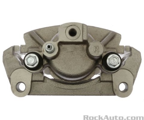

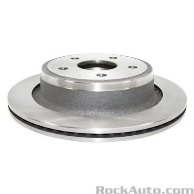

I see brakes talked about alot, I dont see how they are going to be any better on a 2500 then the 1500, even if they are larger the truck weighs nearly 2,000lbs more.
Both come with 17" rims and you can only fit so big of brakes in there.
What am zi missing here ?
I know my 1500 would easily out stopped my 07 2500, but it did have 150k on the clock..lol
Just my 2 cents.
What you say about brakes would absolutely be true if they had the same brakes. Guess which rear caliper and rotor goes on which model truck...
