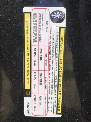

7EA34A7A-70DF-4A29-9E22-18C0F9D31B28.jpeg Yikes. 1061lbs is low... 4 guys a cooler of food and a cooler of pints and you are at max load.
I have nearly 600lbs more than that.
10-15% (12-13% is ideal) of your trailer weight needs to be tongue weight, and tongue weight is part of payload.

I see you used the VIN calculator and got an accurate number.
Now. You see how light your payload is. This means you have a heavy truck.
As stated the payload is a defining number...but can be Did get if you stay under gross axle weigjt ratings. They will be 3900 front and rear.
Now. That max tow number. It is found with a cargo of 300lbs. 90 lbs for hitch and a 10% tongue weight.
So. If you weight say 200lbs...you can take a passenger of 100lbs...or some cargo of 100lbs.
A travel trailer should have a tongue weight of 12 to 14%...much more than the 10% weight.
See how that number came down already.

Thank you so much for this information. Very helpful. It's amazing how quickly the numbers add up. I actually went to the ram site and put in my Vin number to get my exact specs. As for my tires, I don't know. Something else I'll have to check in to. Put on the Falcon Wildpeak AT3W. Again, never thought about pulling anything other than a bass boat. In hindsight, something I probly should've thought about previously.

View attachment 217519 Yikes. 1061lbs is low... 4 guys a cooler of food and a cooler of pints and you are at max load.
I verified everything with my Vin number on the ram website but I'll double check the sticker. I guess the Laramie added quite a few options and weight.
I believe it, it’s just unfortunately low.
