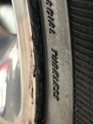

So on the way to the airport last weekend at 5am I happened to get a flat right in front of a Mavis tire. It was going flat fast but I had enough time to get it into the lot before it went completely flat. Luckily I was only 5 minutes from my parents house so I decided to get a ride instead of putting on the spare. I was also kind of lucky that I had two new Goodyears in the back that I just didn't get around to mounting on my rear wheels. The unfortunate thing is that the flat was on the front.
My dad went in when they opened but had somewhere to go, so he told them not to drive the truck since the tire was now completely flat down to the rim. A couple hours after he got done doing what he had to, he went to the Mavis to pick up my truck. Being the car guy he is (I blame him for making me the way I am lol) he goes and looks at the rim since it was now parked in the middle of a huge puddle when they had no reason to move the truck. Well he finds the whole edge of the rim completely chewed up and marks from where they must have pried against the wheel to remove/install the tire. At first they tried to tell him that it was normal "road rash" and that they see it all the time. Then after my dad telling the guy that he was out of his mind, and the guy going out and looking at every other rim that was spotless, he agreed to fix it and didn't charge to put the new tire on. Im assuming they pulled it into their shop with the tire completely flat and probably turned the wheel which resulted in the tire folding under the rim and them basically driving on the pavement with the rim.

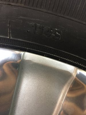

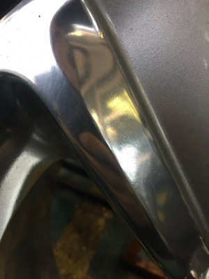

Anyways I got home today and saw the rim in person. Just like I said, they literally chewed up the rim all the way around right on the edge and there are a few places where there are nicks on the face. Now they want to fix it but I am afraid of it not matching. The sport wheels are polished with the painted areas on each spoke. I am thinking about giving them one chance to fix it (Im going to take the wheel off, put the spare on and hand them the wheel/tire), but if it doesn't match the first time, I'm going to ask for a new wheel. Is that unreasonable?
Ill try to get better pics in the morning but these are some that my dad had taken when it happened.

i'm a tolerant person. scuff and scrapes are part of life. no one is perfect. what you have is just plain damage. I second the replace it opinion

I thought about skipping the repair option too.. I know a new wheel is around $650 from the dealer. I understand if they put a nick in the wheel by acciddent but what they did is ridiculous. I have in writing to bring the wheel in to get repaired, so they are admitting fault.

That wheel is shot. I wouldn't have even mounted anything on it as dragging the bead across it is likely to damage the sealing surface of the bead. I've been down that road and it sucks.
You may find the burden of proof is on you if they refuse so be prepared to fight for it however there is no repair that's going to work well as it looks in some places the wheel is cracking.

Needs to be replaced. Skip the repair.

New wheel. Their fault their responsibility. You brought it in with a wheel that was essentially "new" and undamaged, therefore you should be allowed to leave with the same.

New, would you want to rely on a "fix" in a blizzard and have that part of your anxiety or focus on what is ahead of you and not worrying about the what-ifs with a new wheel.

Good luck getting a new rim out of this. I'm sure the scuffs on the wheel edge, as I see them, could be filed, sanded and polish out fine or at least to 95% where you wouldn't see them. Not that difficult to do. I've restored and polished several AL wheels for various classic cars. Uncleared wheels are easy to do and turn out nice ...if you take your time. Problem is, are they going to do it 'right'? Probably not. The scuffed areas on the wheel surface are going to be a different story. They could be cleaned up so as to be less visible, but you'll always see the depression. And most likely the wheels are clear coated which they wouldn't be able to replicate. When you chip or remove the clear (if they 'are' clearcoated), then you introduce accelerated corrosion at the exposed area. The wheels would have to be professionally restored to get the faces cleaned up. And then the problem with getting wheels 'professionally' restored by a wheel shop is they generally sandblast the wheel backsides (creates a different texture) and either paint the backside, clear them, or don't do anything (to the back), so that wheel would be different than the other wheels, even though the fronts would look about the same.
It's probably not worth getting into. Are there any used ones on Ebay that are really nice?

Go to eBay where you can find single replacement wheels for sale for a lot less than $650. Don't let them fix it, but rather have them pay for the replacement.

Well I spoke to the local Rep for Mavis and he said that they HAVE to try and fix the wheel before replacing it. I told him I doubt it will match, but we will see. Now I have to try and find time to put the spare on and give them the wheel..
