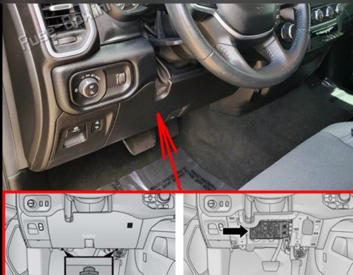

Not sure if cross posting is allowed but this goes to assisting the OP. Read in entirety this thread as it definitely could be your issue, I've seen this a few times and one of them matched your issue to a T.
Electrical Issue
Will not open, comes back DNS error.
Mister Luck
cassis tutissima virtus
Aug 25, 2020
1,651
606
WEST COAST
2016/2017
5.7 V8
Electrical Issue
I found the link through partial search
The fix was ..
Okay, of all things the tow truck driver stellantis sent fixed the truck. Issue was a nut on the number two fuse box input fell off. I didn't notice, but the drive saw the witness mark from a nut that was no longer there. Pushed the area down with a pen, it arced, and truck came to life.”
Not sure which is referred to but I believe it is the fuse box under the hood next to the battery .
turkeybird56
Aug 2, 2018
25,753
56,489
Central Texas
The fix was ..
I checked my fuse box on MY 19 just now. I have "nuts" on all of the posts except #5, as I do not have auxilary items installed.
