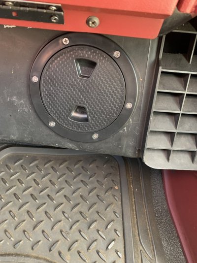

If you haven’t done it already, you probably should. I didn’t think this thing could get so full! Get a deck plate and hole saw. Fifteen minutes and you’re done.
EDIT: First gen Dodge Ram (D/W) Heater box, passenger side. (forgot to add this info in the original post)

Heater box on the passenger side. Completely filled up. I went back and put it in the original post. Sorry for the confusion.

so, where did you find that convenient cover? Not that i need one, but it was the perfect thing to use there.

I'm going to say when you do this job .. Put on a pair of rubber gloves.. There can be some really nasty items in there. Dead rats .. snakes.. spiders.. & Nasty decayed leaves .. I worked at Chrysler for 11 years not much bothered me... But I sure hater to reach in there & See what my price for the day was ..
