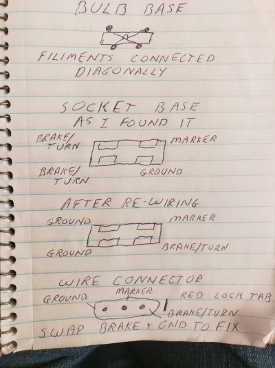

I just installed my 7" EVIC and I'm having issues with intermittent parking light failure warning. I understand this is fairly common, especially with LED's, but I'm running standard incandescent bulbs. With the marker lights on, if I apply either the brake or turn signal, the marker element goes out and I get the warning. Is it normal for the marker element to go out? It doesn't seem right, but I never checked with the 3" EVIC installed.

Good job, thanks for the follow up, I know it will happen again and now we got the fix.
