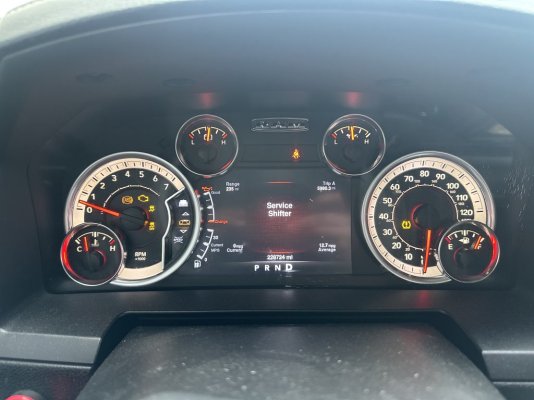

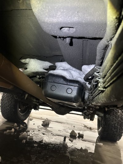

We had a really wet/heavy snow and freezing temps the following night. The bottom half of the truck was packed with ice. The first thing that happened was a “service shifter” message. After that all hell broke loose with intermittent random messages and all dash lights blinking on and off. After parking the truck and turning it off, it acted like the battery was dead. The gauges would flicker but after 30 seconds the truck would come alive, flashing all the messages again. During this I could randomly start the truck/put it in gear. I thawed the truck out inside for 2 days, no change. I checked battery voltage and it was at 12.3v. Replaced the battery with no change.

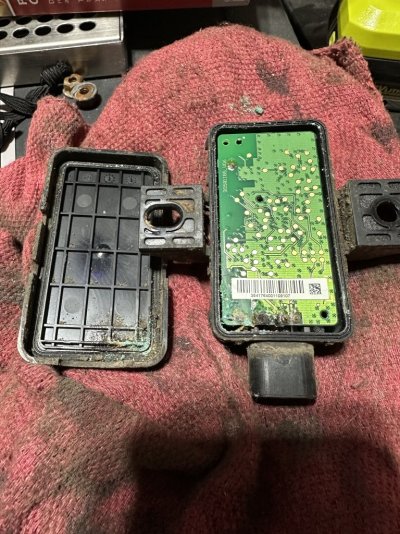

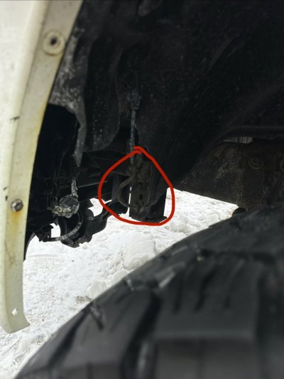

Looking into the wiring diagrams, turns out it’s the TMPS module. Checked continuity and found 90 ohms to ground on the (yellow) CAN- wire and OL on the (green) CAN+ wire. Disconnected the TPMS module and the wiring checked good between both connectors. I opened up the TPMS module and found the board shorted between the power/ground terminals due to corrosion. Most likely due to the ice/water intrusion.
