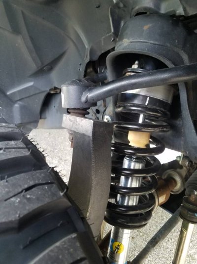

This is my worry the angle is complete crap. But the irresponsible part of me doesnt want to correct it if there isnt a huge risk in 2wd. Being hard headed sucks lol. Its not that I'm a dummy I know better just choose to go against the grain sometimes.20200710_173202.jpg

So from what I see in the pic;
-CV angle is awful, but that isn’t a huge deal if you are going to limit 4wd use to almost never.
-sway bar end link is not going to be too happy at its lower mount
-tie rods are pretty steep, especially at the rack end, which could hurt the rack
-cant see upper control arm or upper balljoint.
Did it fully align to within a tolerable spec?

Haven't got it aligned yet got home from the shop that installed it and did the look over and found they left the preload spacer in with the maxed bils. Was going to get it aligned yesterday but canceled till I figure this mess out lol. It's not my dd anymore and like said never been in 4wd but there is always the chance while camping. 42137a222e7ba29ab863736af5e8474e.jpg

Also the preload spacer ls 1.5 inches how much lift is that actually providing only 1.5 or is it amplified like normal spacers?

That 1.5” spacer should only be providing 1.5” of lift. I would remove it, get it aligned and be happy and worry free.

Jack it up to just before the tires leave level pavement and take full lock photos both sides. You’re really testing the 5100s extension as they aren’t designed to geometry of the additional 1.5” spaced.
For reference, I used to run a custom machined billet 1.125” spacer that equated to a 1.5” actual fender lift. You’re probably adding ~2” to your 2.8” and the first failure mode will be that upper control arm joint.
When that separates you’re going to have 14” wheel into the inner fender and the truck will be totaled, depending on the speed you are putting others in real danger as well so at least I tried and don’t have family near you.
