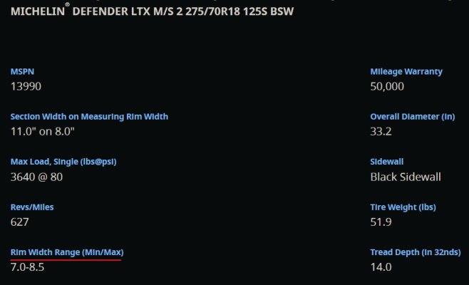

Most tire manufacturer's websites will specify the rim sizes, including the range of widths suitable for that specific tire.
