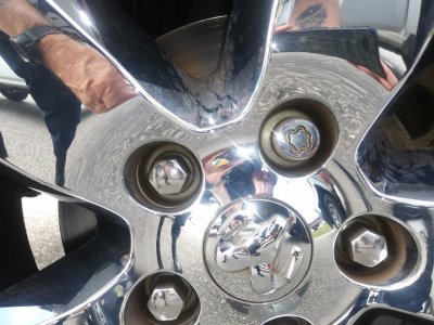

I know this is an old thread but hopefully someone can help me out....
Took my 2015 Big Horn in last Thursday for recalls(I'm the 2nd owner) and an oil change/tire rotation. Tech calls me back and tells me he needs the wheel lock key cause his master set doesn't have one that fits. He says he didn't find mine in the glove box. I don't remember ever taking it out of the truck. Anyhoo, after going thru the forums I saw that McGard.com is where I could get a replacement....problem is I did not find a McGard card in my truck...
Any suggestions before I go and hammer a socket on them and use a breaker bar?

I would call McGard, give them the details and a picture of your wheel lock and they might be able to help you.

I appreciate all of the replies! My "weekend" is Thursday and Friday so in the meantime I'll look for the key under the seat(s), call McGard and see what they say and Thursday morning make the call on whether I'm ordering new keys or finding 4 old sockets, a BFH and a breaker bar and taking matters into my own hands!

I was the second owner of my truck , and did not get the spare tire key. :(
I called McGard and then I emailed them a close up pic of the spare tire lock.
They matched the pattern and I had a key in less than a week!! Was less than $20
The car dealership wanted to cut it off for $150.00+
