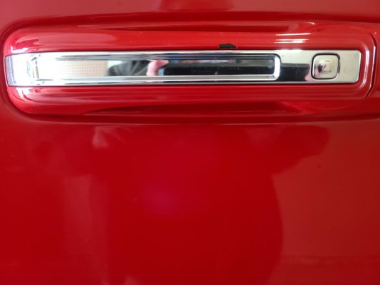

Welcome to the forum. Does your vehicle have proximity lock and unlock. It is activated to unlock by touching the front door handle, and locks by pressing a small button on the right side of the outside door handle. If it does, you can lock and unlock without setting off the alarm. If not, you will need the dealer to deactivate, or AlphaOBD and an OBD reader. Total about $100. Yours is a 2012, so no security cable is needed.
