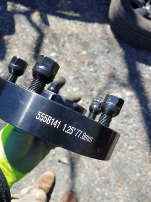

Alright. I received them. I will send photos this weekend. There is no indication on them as to where they were machined. My gut is telling me this is not American. The lug bolts are stamped metric 10.9 which is good. Usually I think the letters are raised. These are stamped. The lug nuts are stamped 14x1.5.

Black beauty I installed them. I also talked with the company on the phone. The rep told me they are made in China. He also said they were 6061 aluminum with 10.9 alloy steel bolts. This company has businesses under a few names including wheeladaptersusa.com. They also sell on eBay. He said it is the way they market. The return address is in Chino, CA. I used phone number 909-393-9190 to talk with them. They will accept returns with a 20 percent restocking fee. They will also custom make them for you here in the US but the cost would be nearly triple. I paid about $111. I torqued everything to 130 ft. lbs. with blue loctite and anti seize grease on surfaces as per a recommendation from a RAM service tech who uses adapters on his personal truck. He said check everything at 5K miles. I will do a spot check at 500 miles and update. So far so good though on a 100 mile trip at 75mph. If I were to do it all again though for an additional $88 I would have bought Bora’s for peace of mind. It is important to note that wheel adapters USA sells “mostly adapters manufactured in China” according to them. They do have a mixed bag of satisfied customers and not satisfied customers with the largest complaint being they do not pick up the phone. For me I called and left a message requesting a call back and did not get one. On a second and third call they picked up both times and were pleasant to deal with. If you can’t afford the Boras I suggest calling this company and gather the info you need from them before making a purchase.

Good write up! Glad they’re working good for ya and no vibrations. Sucks they’re made in china but yea I agree with ya, might as well spend the extra few bucks and get the boras for a better piece of mind.

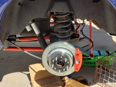

Just for comparison sake. This is a 1" BORA spacer on the rear. I had to cut my studs to 1" to clear my moto metal wheels.
