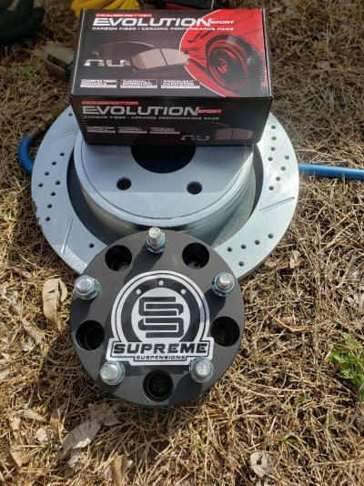

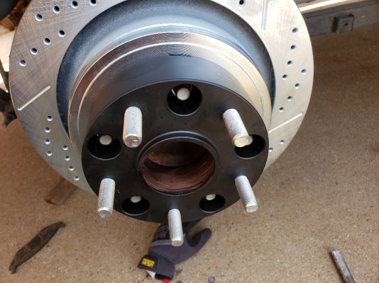

IMHO, you can't go wrong with the hub centric spacers. I have a 2015 1500 Lonestar ED. I've had my Supreme Suspension spacers on for over year. Which for me that's like 5 years. I drive 150 miles per day, 6-7 days a week to and from work.
I installed the 1 1/2" ones on my truck. I wanted the same thing as you. I really wanted the wheels/tires to fill in with the fender flares. I should have gone to 2" instead. Regardless, I do like these spacers.
Anyway, read all installation instructions. I didn't have to make any modifications. Just take your time, torque as directed. Recheck after 500 miles.
I do not get anything from Supreme Suspension.
