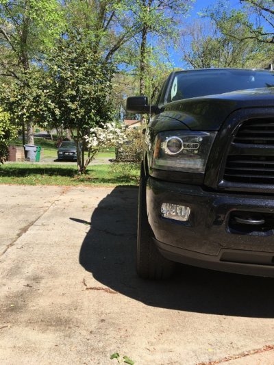

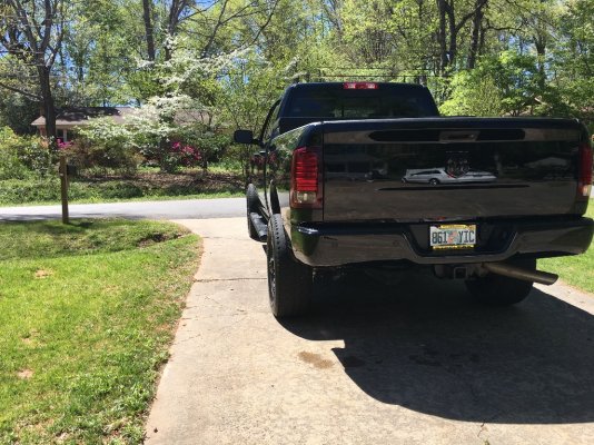

From everything I've seen, 1.5" spacers a 12.50 tires will sit close to flush with OEM flares. If you go to Cummins forum there's a whole thread on wheel/tire fitment with pics
Andrew09HEMI
Feb 26, 2014
812
264
So I think the factory tires would sit flush with OEM flares based on these pics and a 12.50 would sit slightly outside them
Thanks for the pics. This is about where I'd like to be. What are you running again... 1 1/2"?
