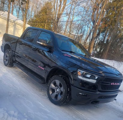

Background: I love Ram 1500s. I've had 13 of them over the past 30 years. Only one with a bad battery (a 2017 Bighorn whose battery crapped in less than a year) but this doesn't appear to be a battery issue and I don't know what I might be facing.
Eight months ago, I purchased a 2022 Built to Serve 1500 with 36,000 miles on it. It currently has 41,000 miles on it. Haven't had any problems until yesterday morning when I went to go to work and it wouldn't start.
Truck is parked outdoors. Temps here are not that cold: It's been a fairly steady 27F. I tried multiple times and maybe the 10th try, it turned over so I drove it to work. Went to re-start it and NOTHING. Lights come on but pressing the Start button just gives a click or nothing at all.
Tried to jump from a jump box. Nothing. Tried traditional jumper cables. Nothing. (I've since read on this forum that this was a bad idea??)
Removed the battery and had it tested at local auto store where it showed it was 67%. Store charged it to 100%. Reinstalled the battery and still wouldn't start. Tried the Start button multiple times, quickly, and it FINALLY started and I was able to drive it back home. The dash read, "STOP/START Not Ready. Engine temperature too low" and once I turned on a little heat (on the lowest setting) the dash read " STOP/START Not Ready Cabin Cooling or Heating". I ignored those because the truck was running, so I drove it home. I shut it off, then tried to restart it and nothing. Lights come on but nothing happens. At least it's in my driveway now.
I've read through similar posts on trucks of different years. Any idea what it could be? I want to have an idea in mind before I have to have it towed to a dealership (unless I can magically get it started and take it to a dealership). Neither of the two Ram dealers near me is particularly reputable and the dealer I purchased it from is ab 45 minutes away (too far for a tow $$$ and even if I get it started, I don't feel safe driving it on the freeway that far). I don't want to get lied to by a dealership service dept. I have read a LOT on this forum and trust your knowledge first to give me an idea(s) of what the problem might be.

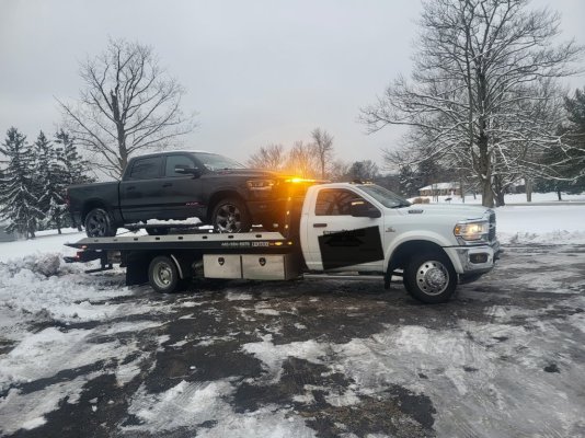

I missed your replies before I gave up. Thank you everyone who replied. It was 23°F and windy AF today, so I wasn't up for digging out the snow and crawling under... I caved and had it towed to a dealership in another town (neither of the two dealerships I mentioned in my first post). I'm worried, of course, but will wait to see what they say. I'll update once I hear from them. 20251203_082619(1).jpg
