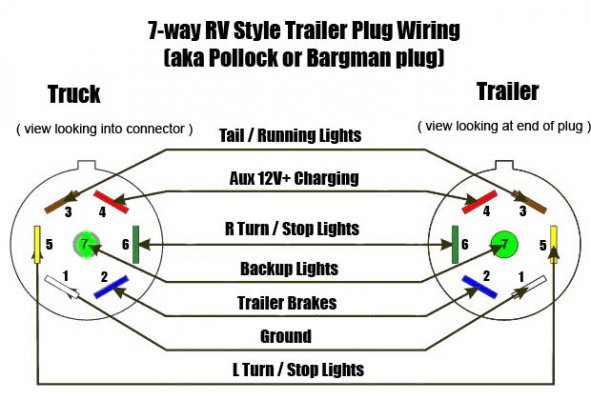

Here's a visual aid to help. Everyone that tows should have this on their phone unless you've done it enough it is memorized.
