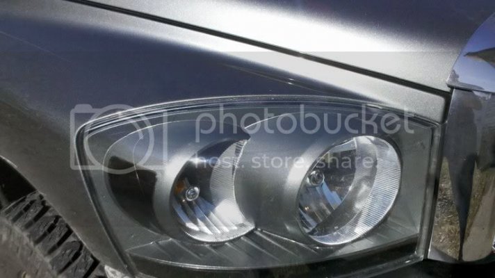

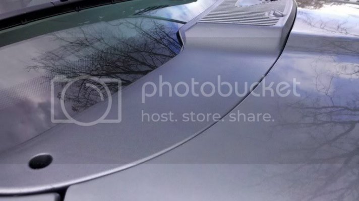

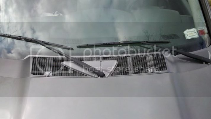

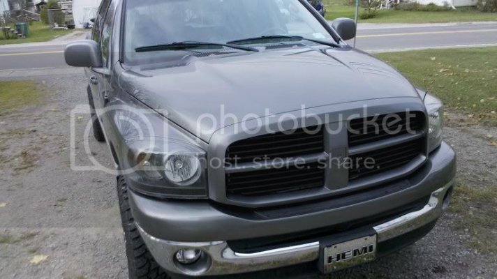

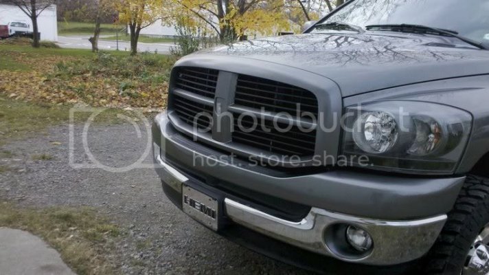

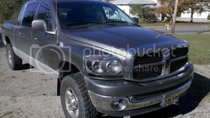

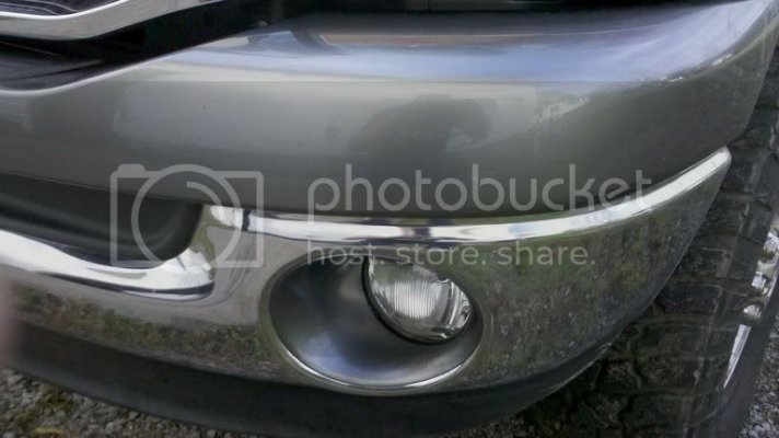

The duplicolor paint code is bcc0331 I'll be back in a second with pictures
Painted cowl
Fog light bucket
Color matched headlight with VHT reflectors
Grille
Stangshcky12
Oct 26, 2011
9,046
942
Oshkosh, WI
5.9 Cummins
It's been awhile since he did his cowl and other trim maybe two months since his grille
He's very pleased with the way it all came out and the way it's holding up. If doing trim like this prep I huge and adhesion promoter is a must
