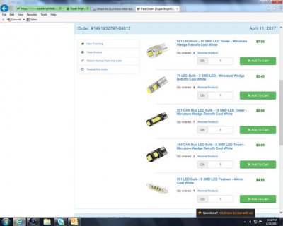

From www.superbrightleds.com
Check it out from my order:
(2) 921 Bulbs - Map Lights
(4) 74 Bulbs - Visors
(7) 921 CAN Bus Bulbs - 2 for foot wells (other 5 used in reverse, cargo, and 3rd brake with no errors)
(3) 194 CAN Bus Bulbs - 1 for upper glove box (other 2 used for license plate lights)
(1) 561 Bulb - Under the hood (if equipped)
Not seen on picture but also ordered from SBL for Dome light:
(1) 578 LED Bulb - 8 LED Festoon - 44mm Cool White
All direct replacements with no errors. Did not need the CAN Bus for the footwells or glove box but I was already ordering the CAN Bus's for the exterior lights so I figured why not...

Thanks for posting this.
Are these interior LEDs compatible with trucks with the LED upgrade?

TBH, I have no idea what upgrade you're talking about.
I know this thread is for the interiors, but just as a heads up because I also have the exterior bulbs listed, in some trucks you will still receive bulb out errors with the 921 CAN Bus LED's in the reverse and 3rd brake lights. It's a crap shoot, I got lucky with no errors.
