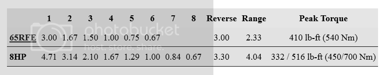

Before you spend any money read this. With the 8 speed and a 3.21 axle you've already got a very low first gear ratio much lower then the 6 speed and 3.92 many people have with their Hemis.
Does Ram need lower axle ratios? • Allpar News
The first 2 ratios are lower than the 6 speeds first ratio and it never catches up until your transmission is in 8th and the 6 speed is in 6th.
wait the 8 speed puts out 516 torque? it was being advertised at 410
