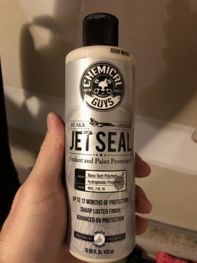

Pull Ya
Jan 16, 2012
16,061
23,909
Cedar Creek, Tx
Chemical guys makes pretty good products along with Adam's who is one of the sponsors of the forum. I usually get my supplies from "autopia" which is a worldwide detailer site that also sells numerous products. They have lots of really good information on the site also.
