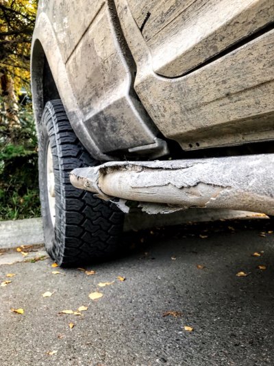

[QUOTE="Low_Sky, post: 1825335, member: 31873"
[/QUOTE]
Is that White Knuckles black power coating peeling off? Or is that something you put on? I might need to rethink this and just order bare mental and spray paint them myself that way I can alway touch them up.
Low_Sky
Mar 9, 2015
374
299
6.4L
Is that White Knuckles black power coating peeling off? Or is that something you put on? I might need to rethink this and just order bare mental and spray paint them myself that way I can alway touch them up.[/QUOTE]
Your images aren’t showing up, but if those are my pics... that’s Line-X. Bedliner isn’t a good coating for sliders that are really going to get used. Mine aren’t WKs, and when I got them made I didn’t plan on using them as hard as they get used, they were “just in case” sliders and Line-X seemed like a good idea. When they get bad enough I’ll strip the Line-X off and start rattle canning them.
